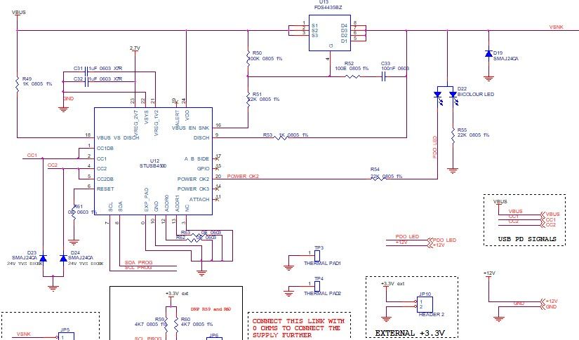

please provide a block diagram + vbus/vsink snapshot on scope on SPST toggle

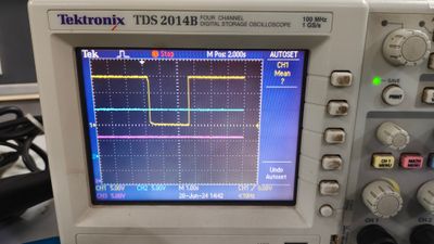

Here are the waveforms for VSYNK (Pink) and Switch (Blue). Captured onn the event of abnormal operation.

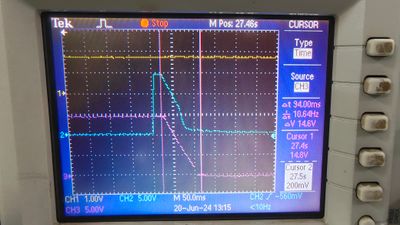

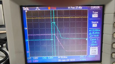

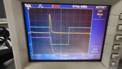

2024-06-20 4:18 AM
Hello NBALL,
Attaching Normal Operation and Abnormal Operation DSO shots.
***Normal Operation***
Yellow: Switch OFF and Switch ON condition
Blue: Vbus_Vs_Disch (constant +15V)
Pink: VSNK (+15V)
***Abnormal Operation***
Yellow: Switch ON condition (Not Made OFF)
Blue: Vbus_Vs_Disch (dropped for sometime)
Pink: VSNK (falled to 0)
What necessary steps must I take to avoid falling of the Vbus_Vs_Disch?
