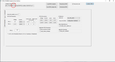

I have resolved this issue by using the previous version ( STSW-STUSB002 GUI 1.09 ). So my hardware got detected in this version and I was able to program or write the NVM successfully. In the Connection Status of the GUI 1.09 it showed that " OK STUSB4500_L Detected (COM19), at address 0x28 (I2C bus 1)" sharing image below.

Hello
Checking accurately GUI snapshot it seems that you are using STUSB4500L and not STUSB4500.
STUSB4500L is TypeC only, not USBPD. It can explain why you never get power nego with this part...
Best regards
Nathalie

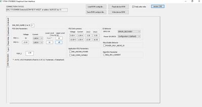

The IC I'm using is STUSB4500 which is confirmed. In GUI version 1.09 it shows L but the IC is STUSB4500 only. Sharing screenshot of GUI version 2.0 for your reference.
