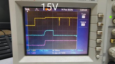

I'm getting CC communication and VSNK_ENB is also toggling from 0-5-0 right now for 15V and 20V selection.
Just VBUS is not setting to 15V and 20V. Attaching waveform below.
Channel 1: CC1 (Yellow)
Channel 2: VSNK_ENB (Blue)
Chaneel 3: VBUS (Pink)
How does in the VBUS parameters the Discharge time to 0V and Discharge time transition to lower PDO voltage affects the VBUS?

2024-06-06 6:41 AM
Hello
As already written without having message content I cannot debug further.
I observe result of a contract at 5V, this is just what I can say.
As mentioned in datasheet discharge parameters are to discharge VBUS on connector/vsink path during down transition or cable removal.

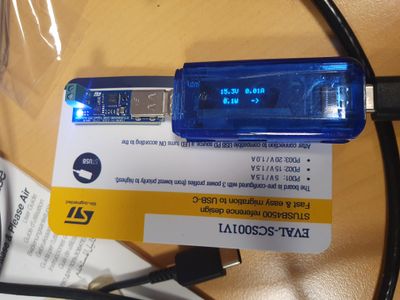

2024-06-06 11:53 PM
board out-of-the-box connected to 45W PD source

2024-06-13 2:14 AM
Hello
I repeat: without protocol trace and full NVM content, no debug is possible.
Device makes a request on 5V: i have no clue why without having the traces. If source_cap are fitting with sink PDOs there is no reason to not take higher voltage.
As shown in picture, device is perfectly working and 15V/20V are 'default PDOs ' when we sell the chip.
Best regards
Nathalie
2024-06-13 2:31 AM
In the snapshot you send the device is working fine for the default program. Could you just try reconfiguring it with the PDO 2 setting as 15V and see if it sets. I have reconfigured the eval board and also another 3 custom boards. This issue persists on all the boards I have.
