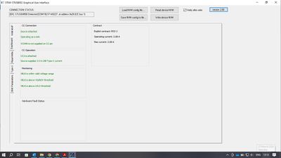

I have resolved this issue by using the previous version ( STSW-STUSB002 GUI 1.09 ). So my hardware got detected in this version and I was able to program or write the NVM successfully. In the Connection Status of the GUI 1.09 it showed that " OK STUSB4500_L Detected (COM19), at address 0x28 (I2C bus 1)" sharing image below.

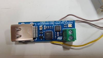

May I ask you to share a picture of the board you are using ?
As per the snapshot shared, it seems it is eval-scs002v1 and not eval-scs001v1.
As eval-scs002v1 is stusb4500L which is TypeC only: you will never be able to get more than 5V.

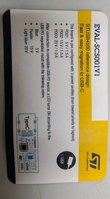

The Eval board I ordered is EVAL-SCS001V1 (image attached below) but in the GUI in connection status why it is showing STUSB4500_L don't know instead it must show STUSB4500. Don't know if this is creating an issue?
I think the device I have ordered is right!

Also I have an update, my configuration worked and I got +12V at the output. In dashboard window its showing PDO3 is selected (Attaching screen shot for your reference). I have changed the source to PD compatible.
So basically what I have understood is the source which we are using must be compatible to sink i.e the source must have USB PD 2.0 if your sink is PD 2.0. I have also tried on source supporting latest PPS technology having the required output profiles but it didn't worked with eval-scs002v1. To work with the sink having PD 2.0 source must be PD supported. I have one doubt please enlighten me on this., In STUSB4500 datasheet it is given PD2.0 , PD3.0 compatible then why it didn't worked for PPS. As PPS is extension of the PD3.0 what I think it must work.

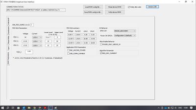

I have one observation regarding NVM PDO configuration. I have connected the load to the output of eval-scs001v1 which I measured and found 12V. In the Dashboard of GUI it is showing "Explicit Contract with PDO 3". But on PDO3 I have configured 15V profile and on PDO2 12V. What can be the possible cause that profile Explicitly selected is PDO3 but the output I'm getting at eval-scs001v1 is +12V, it must be +15V according to the selected PDO3.
