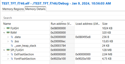

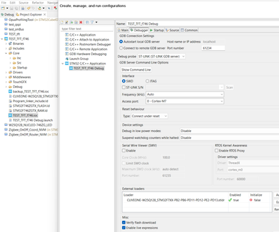

I add the stdlr file in my project and setting the run configurations like :
The datas are in the flash memory :

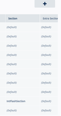

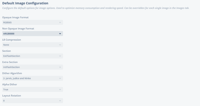

The configuration of my touchgfx is

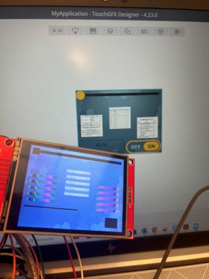

The Background image is not in the flash it works but the others in flash doesn't.
this what i have
Do you have any idea why my image in flash is wrong.
