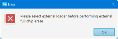

2025-08-26 3:37 PM - edited 2025-08-28 5:55 AM
@Aziz BRIGUI
The error popup appears when I attempt to erase an entire QSPI Flash chip. It is particularly odd as I do verify that the first sector is erased with no error before using the entire chip option.
I prefer to erase the QSPI flash manually before programming after single sector verification first. This worked for me for couple of years until version 2.18. That's when "no external loader" popup first appeared. Reverting to v2.17 allowed me to use my External Loader full chip erase with no issues.
Curiously, if I deselect "skip erase before programming" and Start Programming, mass erase seems to succeed as programming and verification pass. The reason, I prefer to erase first is that the tool does not provide any progress feedback while erasing as opposed to programming and verification having a progress bar.
Single sector erase provides an immediate response verification of the functionality before I use full erase that is taking about a minute or so if everything works as expected.
2025-09-19 9:48 AM
Hello @YuraM,
Sorry for the late reply, totally missed your comment,
There are some additional checks on external loaders starting from STM32CubeProgrammer v2.18. Could you please make sure that the loader name in StorageInfo in Dev_Inf.c is the exact same name of the .stldr file?
Let me know if this resolved the issue.
Aziz
2025-09-22 10:55 AM
Hello, Aziz.
Wow ! This is it. I renamed the file according to the Dev_Info.c name.
All is back to normal for me now. I can use the latest version of CubeProgrammer.
Thank you very much !!
Yuri
