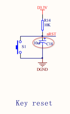

2023-10-26 11:39 PM
Not sure if this can solve your issue, just for your reference, I had the same issue recently, but when I measure the voltage of the capacitor(C18 in my case) of nRST pin, it shows 1.6v, but after the measurement, the connection works, I guess it's because when I measure it, the capacitor get released and cleared, please see if this works for you.

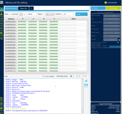

2024-01-07 5:05 PM
Hi!
I tried to follow the method provided in other forums (which is holding reset for 1-2 seconds after pressing connect in the GUI) but I had no luck!
So attempted to change settings and voila! it worked. check out the image below:
(Just in case)
Setting
Port: SWD
Freq: 4000
Mode: Hot plug
Reset Mode: Hardware Reset
Hope this helps!
