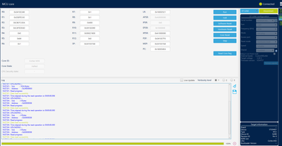

This is the MCU core window after selecting Custom ExtmemLoader.
