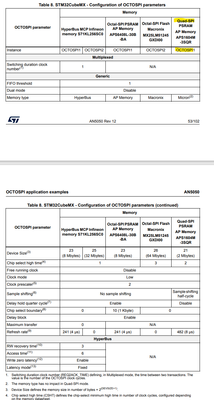

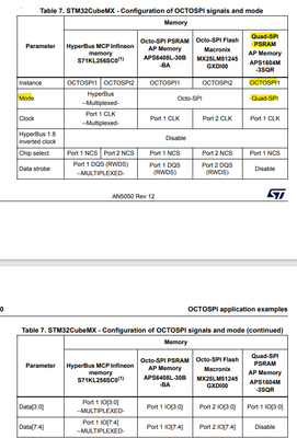

The OCTOSPI interface supports QuadSPI memories. Please look at FAQ: Does OctoSPI interface support QuadSPI memories?.

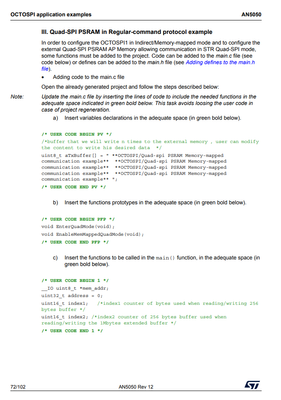

You can find in Getting started with Octo-SPI, Hexadeca-SPI, and XSPI interfaces on STM32 MCUs - Application note and precisely section "7.2 OCTOSPI configuration with STM32CubeMX" an example of Quad-SPI PSRAM memory connected to OCTOSPI interface.
