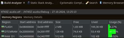

>my program output .elf file size is 1500kb
Maybe - but this is NOT the program to flash !
On my program here the elf is 4 MB ! But code to flash is 169 KB .
So first think, and look , what IDE tells you about code size etc. ->

@Dhatchaneswaran wrote:my program output .elf file size is 1500kb. ?
As @AScha.3 said, the size of the ELF file is not the size of the executable code that goes into the microcontroller.
The ELF file contains a lot more information than just the executable code; therefore the size of the ELF file will be greater than the size of the executable code that goes into the microcontroller - and, therefore, than the size of Flash required.
The IDE build summary tells you the actual memory requirements. If that's still too big, what optimisation level are you using?

Hello @Dhatchaneswaran ,
1- You didn’t confirm that you understood what others said about the size of ELF file.
2- You didn’t tell about the real size of the application either via build analyser or the size of the bin file.
At this stage we don’t know if you really need an external memory for your application.
Could you please confirm the two points above in order to reduce the ping pongs?
