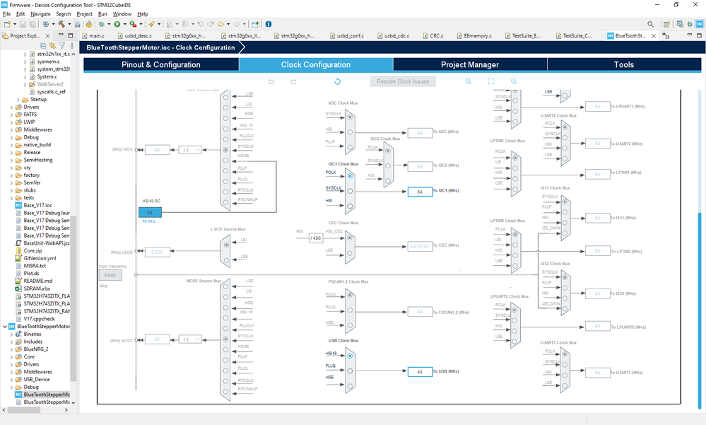

Hello @DCorn
For the USB CDC, it is important to configure the USB clock to the correct frequency, typically 48 MHz This clock is derived from the system clock, so it is also important to ensure that the system clock is configured to the correct frequency as well.

2023-01-13 1:32 AM
Hi
As you can see the internal 48MHz clock is by default linked to the USB. So that's not the issue I think. I have even tried setting Pclk to be 48MHz still did not work.

3-RCC-->Select HSE clock-->(Bypass clock source )
4- Select CDC class in MiddleWares
5-Go to clock configuration --> Set 8 MHz as input frequency
6-Make sure that the frequency for USB CDC is 48Mhz
Please try this solution and I will be waiting for your feedback don't hesitate to raise any question

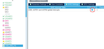

2023-12-21 10:49 AM
Struggling with the same problem here. I think @DCorn solution was pointed in the right direction but didn't work for me because some of the functions to add just doesn't exist in my environment.
I fixed it in the graphical Pinout & Configuration tool:
go to 'System Core' -> 'NVIC' and enable 'USB, UCPD1 and UCPD2 global interrupts'. Save the configuration to regenerate the code and try again.

2025-11-17 5:38 AM
for me, I got USB device not recognized when init project too and I just enable interrupt in NVIC than it work
