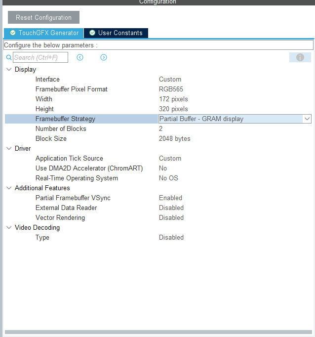

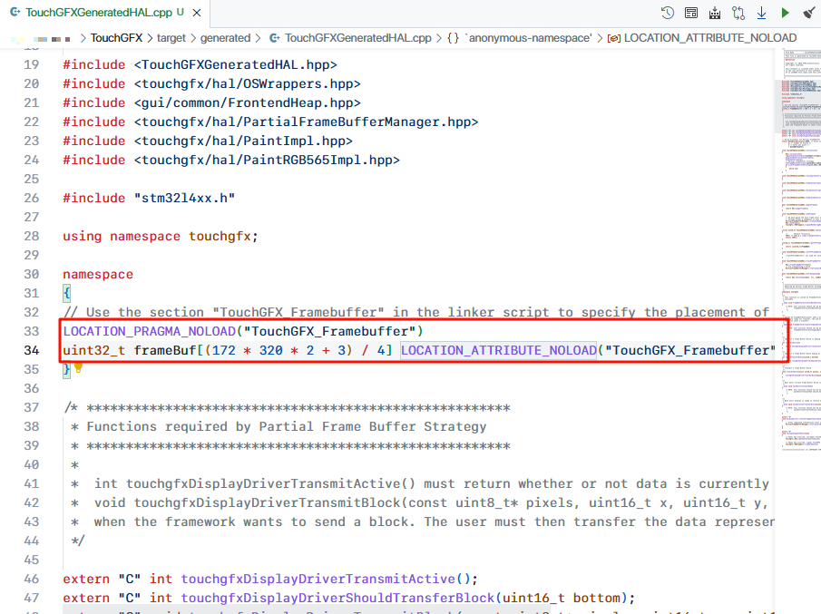

Hello, I'm using TouchGFX on an STM32L452RET6 with an SPI screen. The screen has integrated GRAM, so I selected the partial buffer option in STM32CubeMX. STM32CubeMX generated the partial buffer code as expected, but it also generated code for a full frame buffer, which exceeds the MCU's RAM. I need to comment out this code to reduce RAM usage. How can I prevent STM32CubeMX from generating the full frame buffer code?

I am sharing with your our expert feedback :
"In the documentation LINK we explain that framebuffer can be placed in external memory. If we grey out the double framebuffer strategy, users won't be able to allocate 2 framebuffers in external memory, even if it has the space for it"
