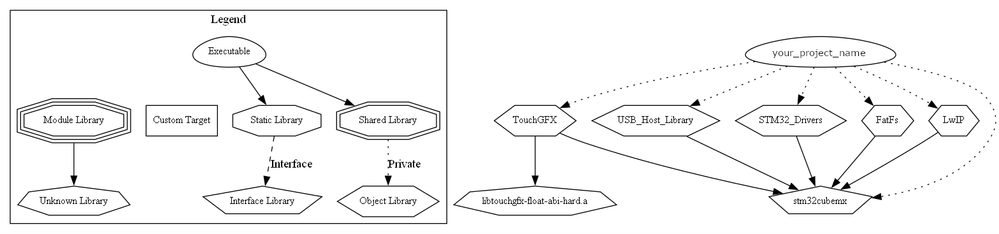

You can generate a dependency graph of your CMake project:
# add_custom_command(TARGET ${CMAKE_PROJECT_NAME} POST_BUILD
COMMAND ${CMAKE_COMMAND} "--graphviz=cmake_dependency_graph.dot" .
WORKING_DIRECTORY "${CMAKE_BINARY_DIR}"
)This graph will contain all the library and executable dependencies in the project showing the dependencies between the targets in a project, as well as external libraries which are linked against.
This will generate something like:
With me it works, but it requires a successful build first. There is some type of racing condition. So I need to comment it out first, build and then I can uncomment it again. If you know how to do this let me know.
