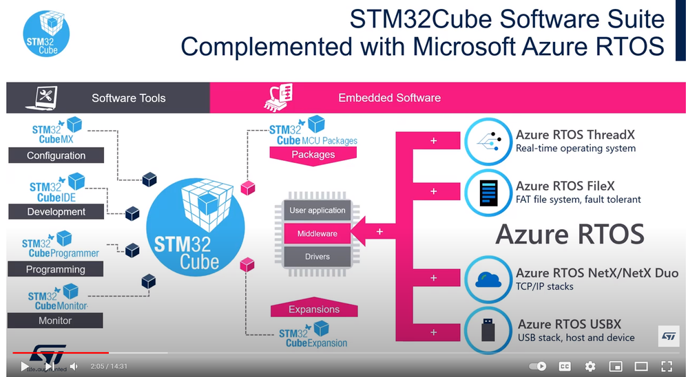

@Amel NASRI has previosuly responded when I've asked about lwIP updates.
But I'm aware that AZRTOS with NETXDUO may make lwIP redundant with ST
https://www.youtube.com/watch?v=OPVhsJfZA5A from 1:58 he talks about ST changing Middleware offering

Unfortunately there is no plan to support new LwIP version in our middleware offer at least in short term.
As previously stated by @Community member, ST's recommendation is to use NetXDuo instead of LwIP.
Hmm. Does NetX provide its own low-level ETH driver or uses the HAL library?
FreeRTOS+ once used a fork of pre-"rework" HAL ETH driver, quite heavily changed.
