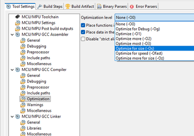

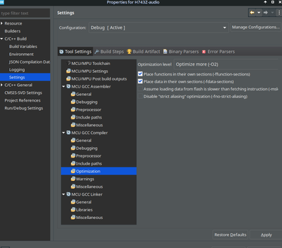

I use always -O2 , best compromise between speed and code size, so i recommend this.
And just set it in C settings... ->

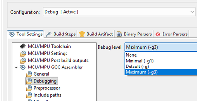

Consider ST ARM Clang (LLVM) toolchain usage too. Picolib mode is much more efficient than GCC but may require some tiny updates of your linker script file.
as extra optimization levels pointed previously
takes care to debug level which may help you experience too
