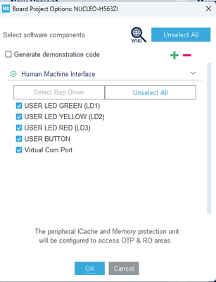

Example, for Nucleo-H563ZI, this message is shown:
And at the left side you have Bsp option:

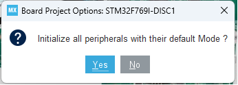

Which is not the case for STM32F769I-DISCO where you have only this message:
And the peripherals are configured by default by CubeMx.
You need to add the BSP drivers yourself to the IDE and manage the errors.
