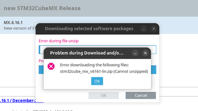

2026-02-14 7:08 PM - edited 2026-02-15 6:30 PM
1. Run StmCubeMX and then chose upgrade in Ubuntu
2. After download it error with something alike it cannot unzip the file.
Reason:
1. it seems CubeMx uses the .installationinformation hidden file in its folder to find the installation folder.
INSTALL_PATHt\00$.....<your patch>/STM32CubeMXt\
These are settings in a binary format, so there are some weird character. Anyhow it cannot be changed by user.
Solutions:
1. Move CubeMX back to where is was installed (not desired) after upgrade, move it back where it is desired.
2. Remove and Reinstall CubeMX
Suggested fix:
1. Make CubeMx upgrade process install folder agnostic.

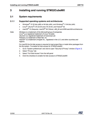

To clarify, MX 6.16.1 is supported on the following operating systems:
• Windows® 10 32 bits (x86) or 64 bits (x64), and Windows® 11 64 bits (x64)
• Linux®: Ubuntu® LTS 22.04 and LTS 24.04, and Fedora® 42
• macOS® 15 (Sequoia), macOS® 26 (Tahoe): x86_64 and ARM-aarch64 architectures
Since Ubuntu 25.10 is not among the officially supported operating systems for MX, its behavior on this OS is not validated or guaranteed.

Hello @debugging
Thank you very much for your answer.
