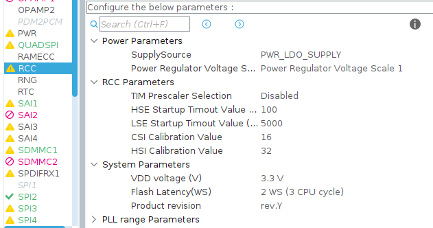

I have updated from stm32cube IDE 1.10.1 to 1.11.0 . After update and open the .ioc file, clock configuration show some problem like the CPU max clock frequency i can't use 480MHz any more.
Do you know anything about this bug?

max clk to choose, depends on core voltage (set:range 0)
+ maybe: chip revision (try: V or Y )

thank you.
Changing the production revision solved my problem
