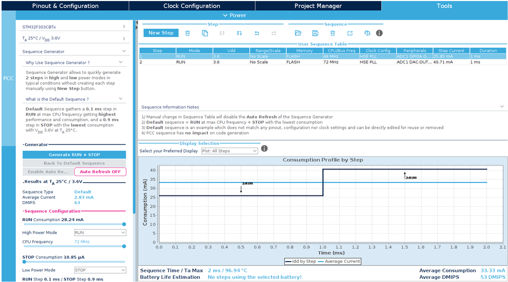

Some of the CubeMX tools can estimate what specific peripheral combinations contribute.

right, see in "Tools" in Cube...F303 -> at 48M + 72MHz
2023-02-24 3:05 AM
I can see 40.71mA consumed at 72MHz.
Can I consider 40.71mA as the maximum current consumed by the IC?

those are estimates as @Community member said,

you just said your clock was 72Mhz, so the estimates are 77,4mA
