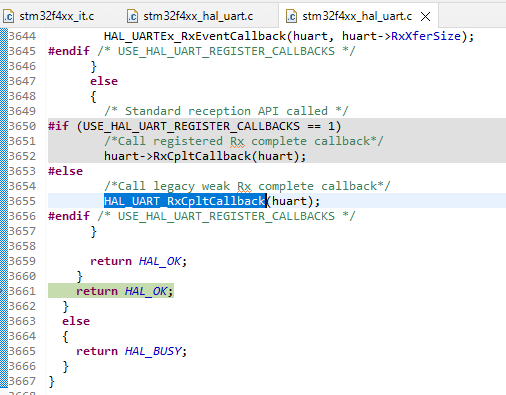

Initialize your HAL_UART_Receive_IT() to receive 1 byte for now.

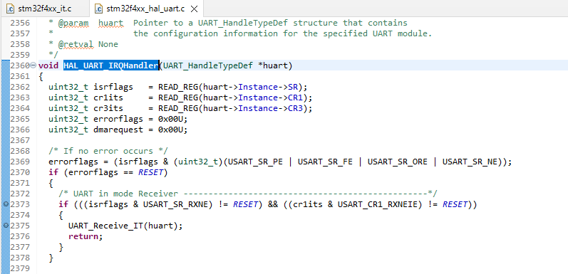

Put some breakpoints in the file stm32f4xx_hal_uart.c at line 2373 and 2375. Run the debugger and send some characters. You should break at each line.

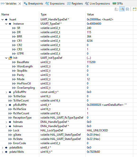

Then step through the code which will go to stm32fxx_hal_uart.c and your huart variable should look similar to this except addresses will be different.
and from there you should be able to step until you reach HAL_UART_RxCpltCallback().
