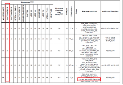

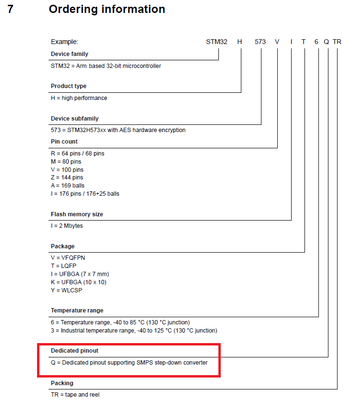

According to the datasheet, the part number STM32H573VITxQ is an 100 pin SMPS package:
According to Table 15, That package doeasn have the two pins RMII_RXD0 and RMII_RXD1 .

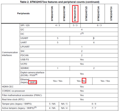

And according to table 2, on 100/144 SMPS packages the Ethernet is not available but some ETH AFs are exposed on some pins due to the constraints of pinouts compatibility in between the product as SMPS packages are consuming more pins then LDO packages.
