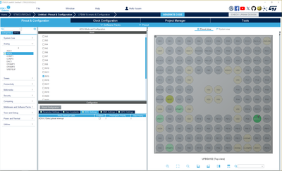

I'm encountering an issue with STM32CubeMX while configuring the STM32U585QII6Q microcontroller. Specifically, when attempting to configure PD11 to ADC4_IN15, I find that the ADC4 channels are grayed out or inactive.
While using STM32CubeMX, I can assign PD11 as ADC4_IN15 in the pinout view, but it remains orange (not configured). However, in the "ADC4 Mode and Configuration" pane, I am unable to configure it.

Hello @ari_v2
It works fine on my side I can configure PD11 as ADC4_IN15 on both "ADC4 Mode and Configuration" and "pinout view".
I think you should update to the last Version (STM32CubeMX V6.11.0).

Yes, I updated and all is OK.
