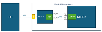

This is a sketch illustrating the connections between the different parts:

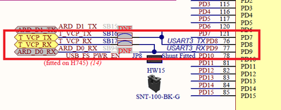

There aren't any known issues with the NUCLEO-H755ZIQ serial port, by default the VCP furnished by the ST-LINK resides on the H755's USART3 using PD8 / PD9. The others should also work for external connectivity, provided they aren't conflicted with other usage on the board.
Here's a schematic if you've not found that yet
https://www.st.com/resource/en/schematic_pack/mb1363-h755ziq-d01_schematic.pdf
>>Is there something I'm missing in my UART configuration that could be causing this issue?
Not really provide any specificity what you've done, or pins you've used. Think of it like the lottery, you're not going to win it unless you have all the winning numbers.. and the opportunities to lose are quite high.
If you need output via the USART, get that working FIRST, figure out the plumbing

The first issue resides in the UART instance selection. You selected USART2 while you need to select USART3 (Tx: PD8 / Rx: PD9) as this is the instance connected to the VCP. That's why before starting to struggle with the coding and configuration you need to check the HW and schematics before!
Same issue as this thread.

2024-08-31 5:54 AM
USART3 is used like a regular USART, you send data to it using HAL_UART_Transmit() functions, and recover via the ST-LINK's COM port on the PC side.
You don't have to configure the H755 as a USB CDC Device.
Make a simple app to enable USART3 PD8/PD9 at 115200 baud, write a simple function to send a string to USART3, confirm you can see the data in a PC Terminal application.
