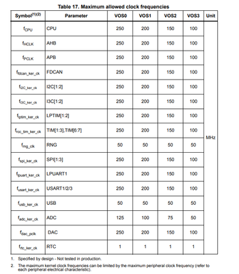

In the picture below, is the configuration that CubeMX shows me when choosing the clock source and the maximum speed allowed to the DAC. It allows me to choose between 6 clock sources and tells me the frequency should be less or equal to 125 MHz when using HCLK.
However, according to the datasheet, both settings (6 clock choices and <= 125 MHz) are incorrect:
When I created the project, the HCLK option was already selected. However, the "clock speed" box was red, saying I couldn't use anything more then 125 MHz. And that's where the problems started, since I had to change the clock source because I didn't want to lower my HCLK to 125 MHz. And changing the clock source to others not stated in the datasheet caused a lot of problems.
After a day of debugging, I decided to use the HCL clock and ignore the "wrong clock speed warning". Everything worked as it should and flawlessly. However, every time that I generate a new CubeMX code, it warns me that there are errors, and it can cause a LOT of confusion for my future-self or others that open this project.

ADC and DAC are sharing same clock source. In case both are used, the clock can't be higher than the Maximum allowed clock frequency for the ADC as shown on the Table 17:
But, if we use only the DAC, User must still be able to select a clock higher than the ADC limit clock. This is a known issue on the CubeMX that has been already reported on the internal ticket 179875 for correction on the coming version of the STM32CubeMX (coming soon).

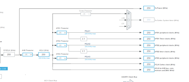

2) When performing a heavy FPU operation, such as calculating a sine wave, which clock is used? Is it always 250 MHz or is it from one of these (picture below) ?
This is my main concern here. I need a very high FPU clock to create arbitrary wave forms using DAC.
And I already noticed that the computations to make such wave forms are heavy.
Therefore if the FPU unit depends on the HCLK, and I have to lower it to make DAC and ADC work, I am screwed :)
3) After your post, I made a quick test using 250 MHz with ADC and DAC enabled and both seems to be working correctly. I connected an external power supply to the ADC input channel and it is accurate and stable (readings from 0V to 3.3V). And the DAC is also working properly at the same time. What gives ?

2) The FPU is clocked from the same source the Cortex-M33 which use the FCLK that works on a frequency up to 250 MHz.
3) As you can see on the first note under the table 17 of the datasheet, the frequency values are specified by design and not tested in production. So, it may work on a frequency more than specified but we can't guarantee this.
