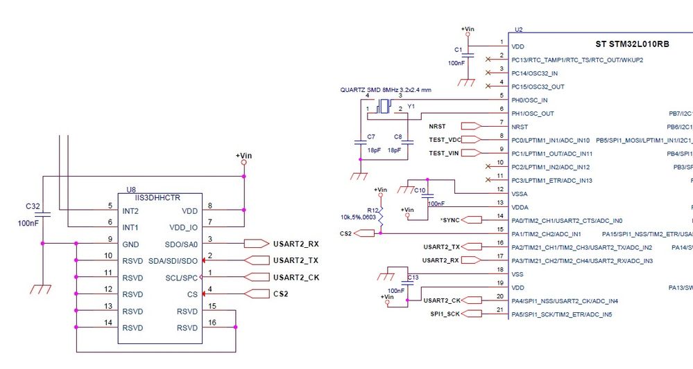

2020-09-02 8:37 AM
What do you exactly mean by "read operation"?
Read out and check/post the USART and relevant GPIO registers content.
What are the hardware connections to the given pins?
2020-09-02 11:57 PM
here a part of the schematics and reading code
cmd[0]=(IIS3DHHC_WHO_AM_I+IIS3DHHC_READ); // read who am i register
HAL_GPIO_WritePin( GPIOA, GPIO_PIN_1, GPIO_PIN_RESET); // enable /CS2
// HAL_USART_TransmitReceive(&husart2, cmd, type, 2, 100); // first try, uncorrect reading
HAL_USART_Transmit(&husart2, cmd, 1, 100); // second try, transmit, disable pin, receive, correct reading
disable_tx_usart2(); // set PA2 pin (uasrt2tx) to input mode
HAL_USART_Receive(&husart2, type, 1, 100); // read operation
HAL_GPIO_WritePin( GPIOA, GPIO_PIN_1, GPIO_PIN_SET);
enable_tx_usart2(); // set back PA2 pin to usart2tx
2020-09-03 2:37 AM
I don't see anything suspicious here...
Read out and post the USART2 registers content.

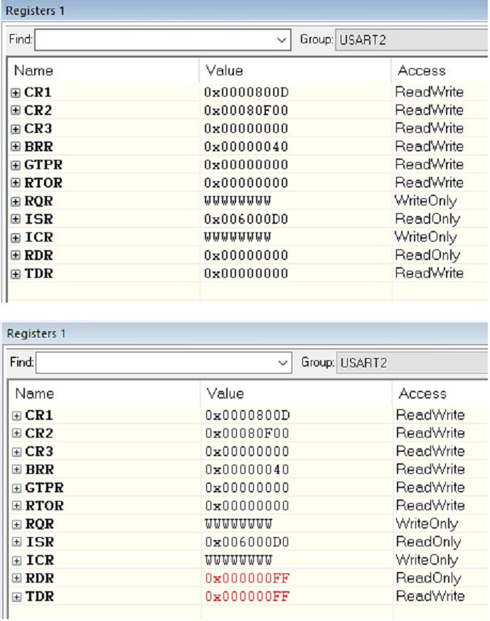

2020-09-03 4:50 AM
here the the USART2 registers condition before and after tx/rx operation; as a 2nd byte is transmitted, in this case i wrote 0xff. If I write 0x00, RDR an TDR will be 00 in the second screenshot.
2020-09-03 3:38 PM
I can't see anything suspicious here either.
Sorry but I have no more idea what could be wrong.
