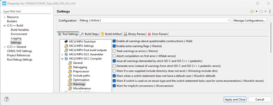

In another attempt to find a clue, I changed the compiler preferences to show all possible errors and warnings, see picture below:
Building the project with this configuration resulted in a shocking list of warnings, many signaling casting issues. Checking on the files involved, I detected a function with useless content, see below:

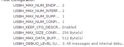

+ did you enable the built in debug messages ? Maybe its helping...
in Cube : USB settings ->

So you can: enable debug messages, to get some info what's going on, or use a tool, to record the running USB transfer and see what happens.

I was not aware of the possibility to modify the Debug level for USB in the configuration window of an USB -Device. I certainly will keep it in mind. And I learned it is not possible to debug an USB connection problem because of strict timing requirements, very helpful to know. Triggered by the two recent reponses on my help request, I tried once more to get USB_OTG running on my WeAct H723VG board.

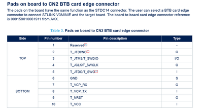

To see the messages, you need serial connection: can use a separate RX/TX to an ST-Link V3 , that has extra serial (and see in terminal or in IDE console -> serial term.), or SWO , to view SWD data and debug messages.
On WeAct board i made the connection to cpu swo pin , board didnt have it on debug connector.
Just ask, if you have problems with this.

>To see the messages, you need serial connection: can use a separate RX/TX to an ST-Link V3 , that has extra serial (and see in terminal or in IDE console -> serial term.), or SWO , to view SWD data and debug messages.<
I don't understand how you create an additional serial connection via the ST-Link V3. I made myself a cable to connect my ST-Link to the WeAct board, with an extra wire from ST-Link pin 13 to H723 pin B3 (Trace SWO), just like you did.

the extra serial is in the ST-Link V3 , on its pins: VCP tx/rx , here for mini E , i have :
and on H7 - any uart, i used uart3 , set to 3Mbit ;
nice on separate serial: you can see your "debug" or info messages without starting debug, even on connecting to a running machine, connect to the serial pins,  just open terminal - and you see , what it tells.
In main needs only a simple call, to send both, always. So SWD with profiling etc in debug, and just the messages, you want to send all time, you connect to the serial rx/tx . (in user code area, so re-generate code changes nothing.)
