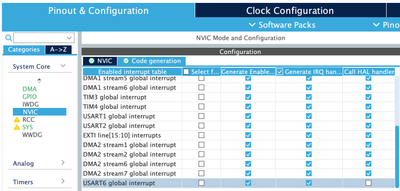

@mƎALLEm
I found the cause, and it was (partly?) my mistake: in the System Core > NVIC > Code Generation tab, the Call HAL handler checkbox for the USART6 Global Interrupt was not checked. After enabling it, the code generation works correctly.

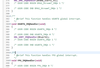

Hello @tykhaytschaar ,
I'm not reproducing the behavior for both projects and HAL_UART_IRQHandler() is there:
Please use the latest version of CubeMx 6.13.0

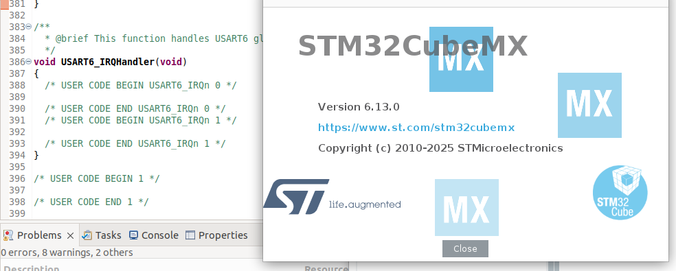

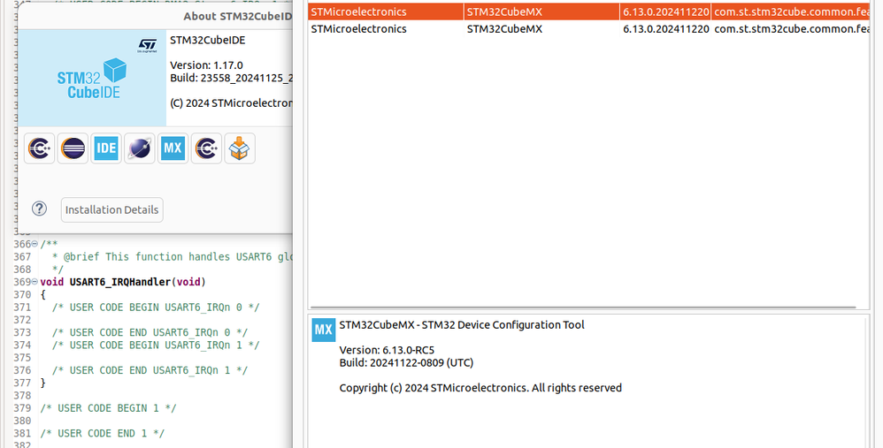

In the meantime I tried to generate code on an ubuntu 22.04 machine with fresh installation of cubeIDE.
STM32CubeMX - STM32 Device Configuration Tool
Version: 6.13.0-RCS
Build: 20241122-0809 (UTC)
The issue occurs on this machine also.

I've downloaded official STM32CubeIDE installer from here: https://www.st.com/en/development-tools/stm32cubeide.html (chose "STM32CubeIDE Generic Linux Installer 1.17" exactly. CubeMX came as part of the IDE, so selecting RCS wasn't my decision.
2025-01-08 6:01 AM - edited 2025-01-08 6:14 AM
Ah! So try to generate the code from the standalone version of CubeMx 6.13.0 and see what happens. It could be an issue in the CubeMx version integrated in the CubeIDE.
2025-01-08 6:17 AM
I installed the standalone version of CubeMX on the ubuntu machine and tried generating the code with it as well. The issue still persists.
2025-01-08 6:19 AM
Could you copy your ioc file to another location and regenerate the code with the standalone version of CubeMx and see what happens?
2025-01-08 6:39 AM
I did, the result is the same.
