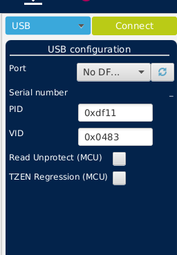

- Started STM32Programmer, chosed "USB" click on "Connect" but still nothing happens, I get the error message "Error: Establishing connection with device failed", screenshot attached.

Just - your PC has to "see" the new USB device - otherwise nothing will happen.
So try other plug, cable - until you see it (in device manager ) or get ding-dong...
+ set jumpers boot0 hi , boot1 lo.
is you clock /crystal on board:
check it.

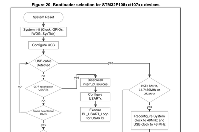

+ read AN2606 ...

CubeProgrammer has managed to connect to the chip.
I had in fact, by mistake, raised to 1 the wrong pin of the component (Boot1 instead of Boot0)
