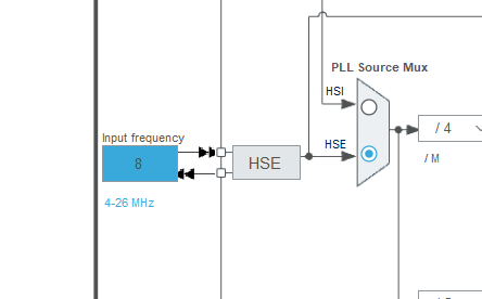

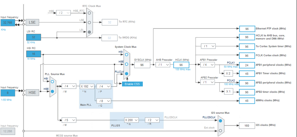

I am trying to set up STM32F411 disc board with Cubemx, the clock tree is set up as default for the board by CubeMx as shown where system clock is set to 96MHz as shown. The generated code for this is contained in function SystemClock_Config(void).
There are two problems with this clock setting:

2019-12-03 3:56 AM
This:
RCC_OscInitStruct.HSEState = RCC_HSE_BYPASS;is wrong. STM32F411 has its own quartz (8 MHz).
So, correct it is:
RCC_OscInitStruct.HSEState = RCC_HSE_ON;Try it.

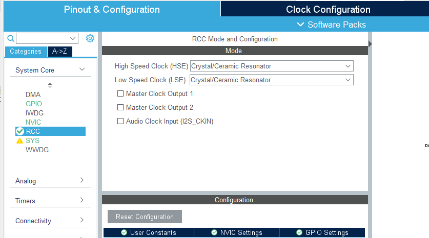

2021-10-20 6:41 AM
lordy lord lord - this is the same bug I had - even with newest IDE 1.7.1 today...
Make SURE to go to RCC and enable the HSE crystal! then both pins will be shown in the clock configuration
