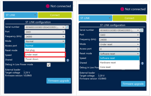

Try to connect the board "under reset" using STM32CubeProgrammer.
May be this FAQ "How to solve debugger connection issues" can help you to solve the issue.
