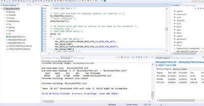

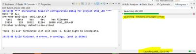

Bsm01
Associate II
Hi @Semer CHERNI ,
I am using STM32F429I-DISC1 board with STM32Cube IDE.
But I see the building every time shows "make -j8 all terminated with exit code -1". Build might be incomplete.
And while starting for Run/Debug, it seems like the flashing to the board is getting stuck.
Could you please help in this case , if I'm missing any tools to install or any specific version of tool will work or any configuration setting to change ?
Thank you...

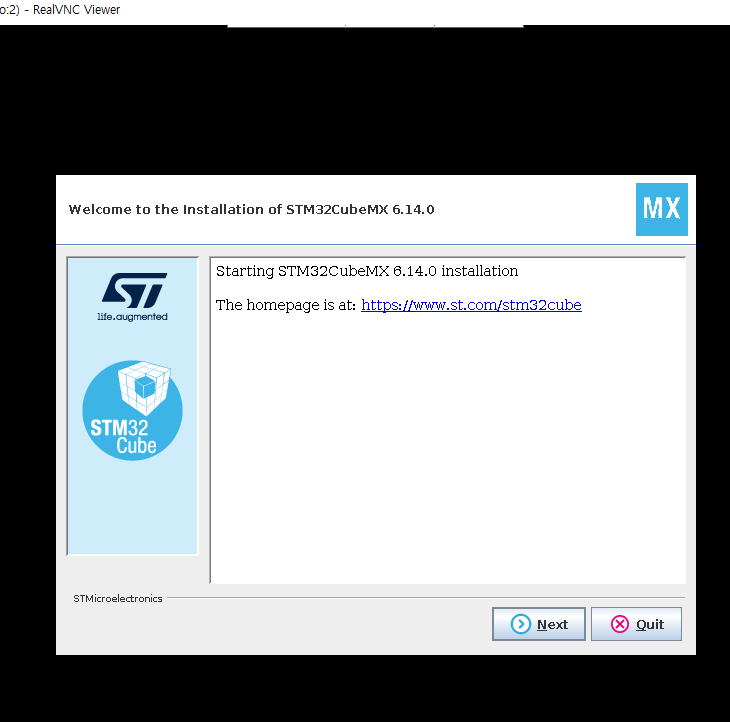

I have same error when install CubeMX latest version.
My Ubuntu machine is in IDC, remote install it.
Console install -- Failed with same java issue.
I Tried Xfvb and x11vnc.
Here's scripts
 Xvfb :2 -screen 0 1280x800x24 &
export DISPLAY=:2
x11vnc -display :2 -noxdamage -forever -nopw -listen 0.0.0.0 -rfbport 5902 &
sudo ./SetupSTM32CubeMX-6.14.0 &
and My PC [installed VNC client , eg RealVnc ]
connect myServer:2
then,
Hello trustfarm, thanks for the hint!
I was not aware that a remote console installation also needs a GUI. Now I succeeded to install the CubeMX by using MobaXterm.
The only obstacle is that the installation dialog
Full command: /home/sth2ot/STMicroelectronics/STM32Cube/STM32CubeMX_6.14/./jre/bin/java
-args[0] java
-args[1] -jar
-args[2] SetupSTM32CubeMX-6.14.0
Command line arguments:
pops up and needs a [1] as input to proceed.
