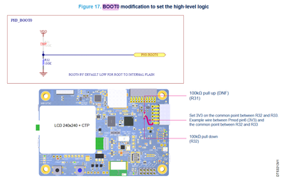

Just to be sure that we are talking about the same thing. Here is the only reference I found about boot0 in the doc.
After setting, boot0 at 3V3 (I did the same setup as the doc), and trying to connect in Hot plug mode the error has changed. Now I have this :

Yes, that's exactly it for the STM32L5-DK. Just make sure to power off/on the board after linking the two points with the wire as shown in this graph above (the power off/on is to make sure the new boot configuration is applied).
If that's done and you still can't connect via Hotplug mode, I'm afraid the chip is no longer recoverable (Root cause is that you most likely changed non-secure boot address Option Bytes or the nSWBOOT0 option bit).

Hello @Aziz BRIGUI,
With adding the power off/ power on part, it worked. I can access my card again.
Thanks a lot for your help.
