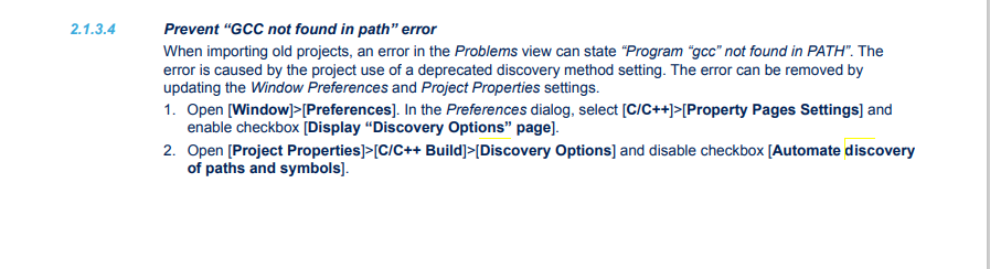

As I experienced some problems with 2.1.0, I reverted to 2.0.0 and in that process I seem to have gotten the error:
Program "gcc" not found in PATH - "[Discovery options] page in project properties"
I followed the instructions found in the stm32CubeIDE user guide https://www.st.com/resource/en/user_manual/um2609-stm32cubeide-user-guide-stmicroelectronics.pdf, but the problem persists.
Is there a way to manually clear this from any of the configuration XMLs perhaps?
The code does still compile and creates binaries, so the error is just a nuisance.
