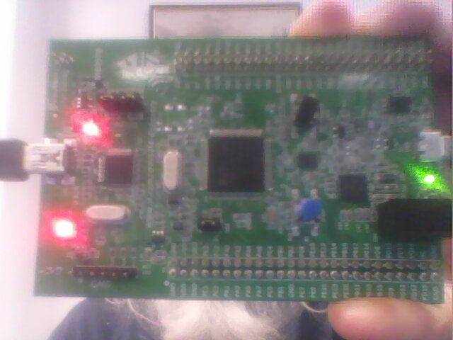

The fact that your board is wrongly recognized is pretty odd. Could you photograph it? also the marking on the STM32 Chip?

Hi @Aziz BRIGUI,
Thank you for your reply. As requested, the photograph.
STM32F407 Discovery Board
The marking on the chip is :-
STM32F407
VGT6
STM32CubeProgrammer v 2.19.0 has not(!) been modified in any way. I hope this is of use.
Stuart
2025-10-09 8:32 AM
Please post a good, clear, in-focus photo!
As @Aziz BRIGUI said, the markings on the chip need to be clear.

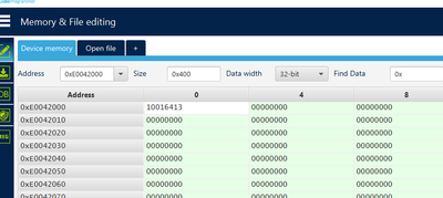

That's OK we understand, could you read @0xE0042000 and send me a screenshot like this one ?
Aziz
