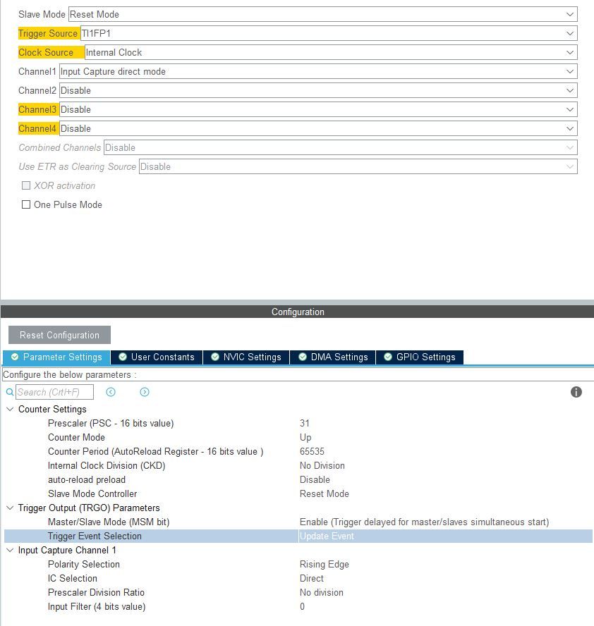

I am running Capture Mode at TIM2 channel 1. My CubeMx configuration below. I am getting CCR1 value correctly but i checked at debugger mode, CCR2 value is always 0. Thus i can't measure duty. What's the problem ?

In that screenshot, Channel2 shows Disable, so it does not capture.

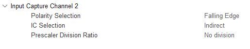

Thank you JW. I review this function and i found solution described as below. Now CCR2 is works.
