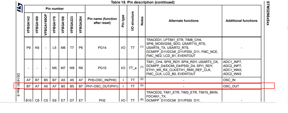

Hello @matt-crc
After double checking the DS14791 Rev 9 :Table 18. Pin description (continued)
The pin type for PH1 is only I (input), so MX is working correctly.
THX
Ghofrane
