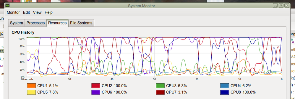

Using CubeIDE both v1.19 and v2.0.0 with Debian Linux v11.11.
I'm seeing very high processor usage, 300% and higher, all of it java based even when there is no activity in the IDE. Is there an explanation available for this usage, or is there a way to bring the usage back down out of the stratosphere, or is there just a leak that's causing this? It doesn't really appear to be affecting anything bigtime so this is just an information inquiry. System monitor screenshot attached.

i am on LinuxMX , have about 0.5% cpu load with browser + stm32-IDE (V 1.18.1 ) running.
+ on compile/link it can reach 100% for some seconds, all 8 cores busy - but thats expected, right ?
How you can get > 100% ? warp drive ? (btw 100% = full max load , so...?)
2026-02-26 11:30 AM
Over 100%, yes, it's adding up the percentages across all the cores. Something is going on in the background that keeps java busy. Just trying to figure out what it is.
