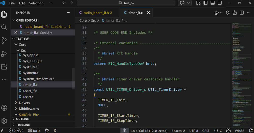

Generating code for the STM32WLE5CBU.
In timer_if.c:
extern RTC_HandleTypeDef h;but in rtc.c:
RTC_HandleTypeDef hrtc;
It happened in CubeMx 6.16.1 and STM32Cube_FW_WL_V1.4.0 and is still happening using CubeMX6.17.0 and STM32Cube_FW_WL_V1.5.0

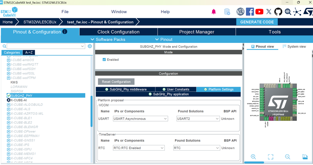

Hello @Tiaan
I used your IOC to generate the code , but before code generation I made sure that the platform settings were correctly selected
After code generation , I have checked the timer_if.c
Could you please double check on your end?
THX
Ghofrane

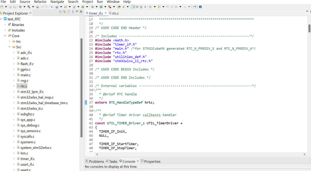

Hello @Tiaan
I tried to reproduce the issue described above using the latest STM32CubeMX version 6.17.0.
In the .ioc configuration, I enabled the following peripherals and middleware:
RTC , SUBGHZ, RNG, and LoRaWAN
I also enabled the option:
"Generate peripheral initialization as a pair of .c/.h files per peripheral"
After generating the code, I obtained the following result:
In timer_if.c
It would be useful if you could share your .ioc file ?

2026-02-25 3:07 AM
2026-02-26 12:09 AM - edited 2026-02-26 12:12 AM
Hello @Tiaan
THX
Ghofrane
2026-02-26 12:19 AM
OK, That was the issue. Thanks
