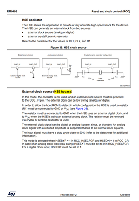

Does anyone know how to setup the clock source for the N657 processor? I want to use an oscillator for the HS clock input and setup HSE = Bypass clock source...
using Bypass clock it should only use PH0 (clock in) and free up the PH1 pin (clock out). But it seems the IDE / cubeMx always wants to use both pins regardless of the clock configuration.
am I missing something or is this a bug?

maybe small inaccuracy in Cube ,or N6 just dont switch off osz-out . (read in rm or errata...what it should do)
But it has enough other pins, so not free up the PH1 pin is nothing to worry about.

Hello @Ghofrane GSOURI
Can you also address this post, this appears to be another bug with the Cube-MX software, where the clock pins are not allocated properly. You can use the same .ioc file as the previous ticket.
Let me know if you need additional info.
thanks
Matthew
2025-10-29 12:36 AM - edited 2025-10-30 5:50 AM
Hello @matt-crc
I appreciate your helpful contributions.
According to RM0486 Rev 2, Section 14.6.2: External clock source (HSE bypass):PH1 (OSC_OUT) is not required for HSE bypass mode.
Ticket 220815 has been escalated to the development team for further investigation and resolution of this behavior.
THX
Ghofrane
2026-02-25 3:26 AM
This issue has been resolved in the latest version of STM32CubeMX 6.17.0
THX
Ghofrane
