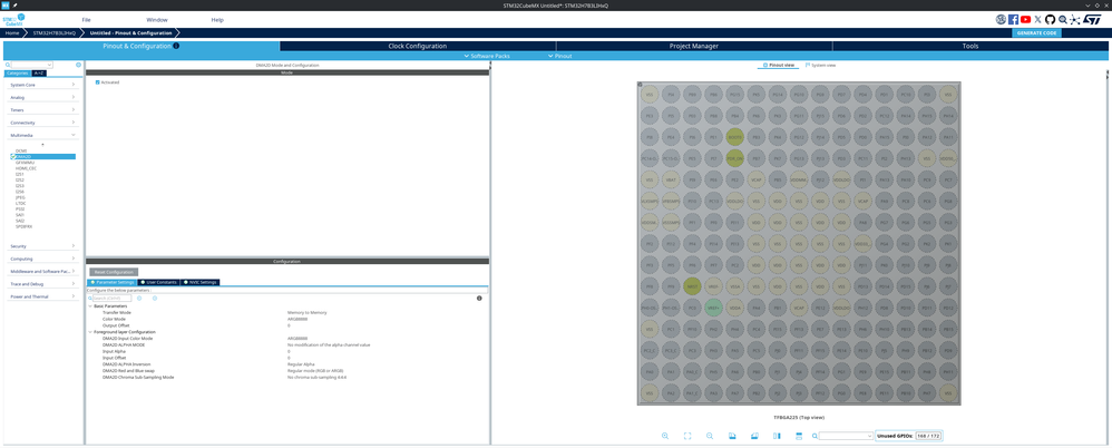

I was playing around with different versions of MCU and I've notice STM32H7B3LIH has no Graphic Accelerator mentioned in Product Selector.
But as soon as I'm selecting it in CubeMX I can enable DMA2D in Multimedia.
And think there are more MCUs with Chrome-ART Graphic Accelerator which are not correctly shown in Product Selector.

You are welcome. The idea is when I'm searching to find a suitable STM32 MCU for my project, some of them are not showing in the list (web or CubeMX) because they don't have the options added in the database.
