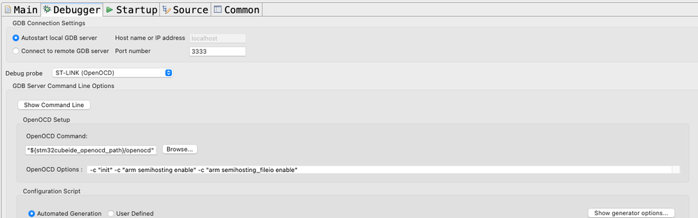

I updated CubeIDE to 2.0.0 (now CubeMX is separated) on MacOS. I started new project and want to set semihosting for debug. I did the configuration as I used to do in previous projects, but now when I try to run, I receive following error:
Info : [STM32WB5MMGHx.cpu] Cortex-M4 r0p1 processor detected
Info : [STM32WB5MMGHx.cpu] target has 6 breakpoints, 4 watchpoints
Info : [STM32WB5MMGHx.cpu] Examination succeed
Info : starting gdb server for STM32WB5MMGHx.cpu on 3333
Info : Listening on port 3333 for gdb connections
semihosting is enabled
semihosting fileio is enabled
Error: The 'gdb_report_data_abort' command must be used before 'init'.
Below my configuration of OpenOCD:
Where should I put the gdb_report_data_abort command?

2026-01-14 3:26 AM
Thanks @Mahmoud Ben Romdhane
I already read this article before. But this time I read it carefully, doing everything exactly as in the article and removing any configuration that I used to have in the past. And it works!
The only additional change that I had to do in my case, was to change reset mode to "software system reset".
