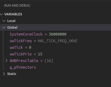

I have designed my PCB with STM32F103CBT6 and a 16MHz crystal oscillator. When I generate code with CubeMX with the clock configuration like the one of the attached images, 'SystemCoreClock', a global variable shows it's 36MHz while it should be 72MHz.
Also, the led blink interval should wait 1000ms while it does only 500ms. It seems the clock is not running properly.

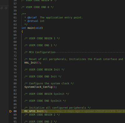

As you can see in the last image, I set breakpoints at Error_Handler(), but I couldn't catch any error there so I assume the config was okay.

SystemCoreClock is 36MHz while it should be 72MHz after SystemClock_Config().
