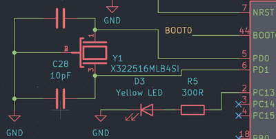

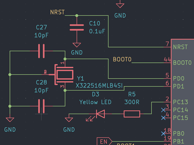

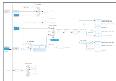

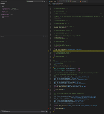

I have designed my PCB with STM32F103CBT6 and a 16MHz crystal oscillator. When I generate code with CubeMX with the clock configuration like the one of the attached images, 'SystemCoreClock', a global variable shows it's 36MHz while it should be 72MHz.
Also, the led blink interval should wait 1000ms while it does only 500ms. It seems the clock is not running properly.
As you can see in the last image, I set breakpoints at Error_Handler(), but I couldn't catch any error there so I assume the config was okay.

I would appreciate if someone could guide me how to debug this. I'm a noob at electronics but I have a logic analyzer, 4ch 100MHz oscilloscope, and lab power supply.
MCU: STM32F103CBT6
Crystal Oscillator: X322516MLB4SI
Load capacitor: 10pF

Hello @hkyu and welcome to the community,
That's weird! X322516MLB4SI is a 16MHz crystal.
According to to your CubeMx, it looks fine.
Are you sure the CubeMx screenshot you shared is the effective clock config?
I have a doubt you are using HSI and not HSE.
Could you please share the part of code generated by CubeMx of the system clock config?

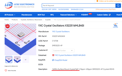

@hkyu wrote:I have designed my PCB with STM32F103CBT6 and a 16MHz crystal oscillator.
That looks like just a crystal - not a crystal oscillator ?

Here is the system clock config code in main.c:
void SystemClock_Config(void)
RCC_OscInitStruct.HSEPredivValue = RCC_HSE_PREDIV_DIV2;
RCC_OscInitStruct.HSIState = RCC_HSI_ON;
RCC_OscInitStruct.PLL.PLLMUL = RCC_PLL_MUL9;
Error_Handler();
RCC_ClkInitStruct.APB1CLKDivider = RCC_HCLK_DIV2;
RCC_ClkInitStruct.APB2CLKDivider = RCC_HCLK_DIV1;
if (HAL_RCC_ClockConfig(&RCC_ClkInitStruct, FLASH_LATENCY_2) != HAL_OK)
Error_Handler();

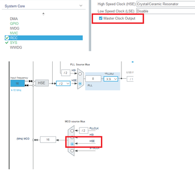

Hello well. For the moment I don't see an issue in this code.
At this stage it's preferable to proceed by steps.

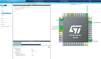

Now try to output the HSE signal on MCO (Master Clock Output) on PA8 pin.
In CubeMx configure the following:
Do you get 16MHz on PA8?
2024-09-30 6:16 AM
Thank you so much for the quick reply.
The datasheet says it's just a crystal.
2024-09-30 6:21 AM

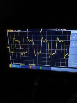

Here is the result:
I suppose it's running properly. The clock cycle seems ~62.5ns, so it's 16MHz.
2024-09-30 6:29 AM
Here it says 16MHz (https://www.lcsc.com/product-detail/SMD-Crystal-Resonators_Yangxing-Tech-X322516MLB4SI_C13738.html:(
2024-09-30 6:36 AM - edited 2024-09-30 6:41 AM
Still one thing to check:
SystemCoreClock value that the system tick configuration is based on.
Get the value of SystemCoreClock variable after executing SystemClock_Config().
