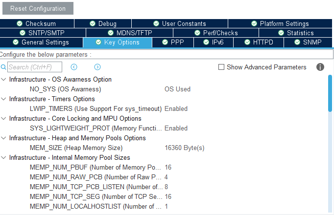

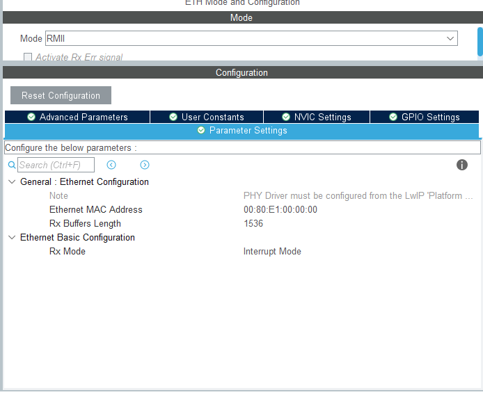

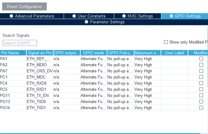

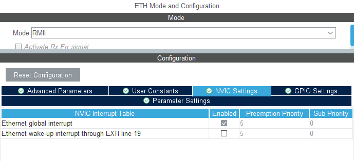

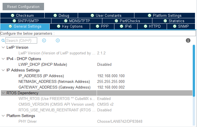

hello every one,
I have one STM32F407ZTE board with DP83848 as PHY.
I want to use STM32cubeMX as initialization code generator.
STM32F4 version is 1.27.1. I try with and without RTOS v2, but I can get ping.

Try to switch to MII mode (Since it's the default mode and maybe there's a HW rework to make to activate the RMII mode) and ensure that the default task stack size is sufficient (larger than 1024). Normally it should work.
