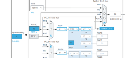

I am trying to use the HSE for Nucleo U5A5ZJ but I have some confusion. The document says ..
"HSE is the 16 MHz oscillator for the STM32 microcontroller. This clock is available depending on the target
STM32 series microcontroller used on the Nucleo-144 board."
So does this board have the external oscillator or not?
In the clock configuration diagram, it defaults the Input frequency to 8MHz. Why?
Even if i use this 8MHz HSE deploying the code to the board results in messages like "Target is not responding, retrying...".

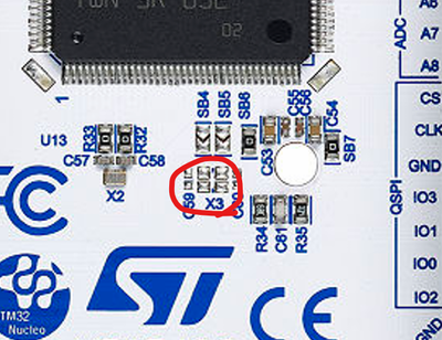

2025-08-15 6:43 AM
Does your board have a crystal in the X3 position, or is it empty?

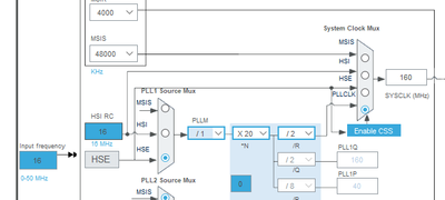

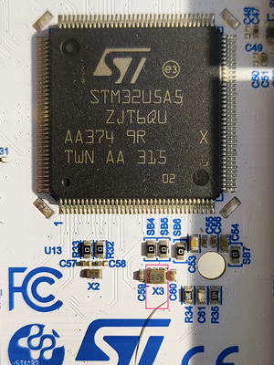

2025-08-15 8:40 PM
Thanks TDK. I do have a crystal here and it says 16 so likely 16MHz. However when we start a new project for STM32U5A5 and disable the USB_OTG, then the default value is 8 for input frequency.
I have updated that to 16 and configured prescaler to get 160MHz sysclk. It looks correct on the clock configuration.
But while flashing it goes "Target is not responding, retrying...". I also check that the FLASH_LATENCY_4 is set to 4. Hope I am not missing something.
