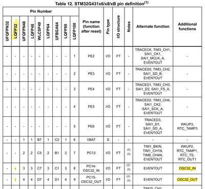

The LQFP32 package (STM32G431K6T6) does not have PC14 (OSC32_IN) or PC15 (OSC32_OUT) pins exposed, which are the pins needed to enable the LSE. Therefore, the LSE is not available in this package and you will not be able to enable it in STM32CubeMX or in code. This can be seen in the datasheet:
If you need the LSE, you will need to use a different chip.
