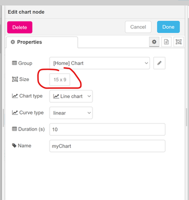

I use CubeMonitor V1.8.0 with my STM32G474QET device. Unfortunately the chart inside the dashboard is very small so I can`t work with it. Is there any possibility to set the size of the graph? The only thing I found is the duration in seconds, but that only changes the resolution but not the chart size itself.

You can configure the chart size in you flow while editing the node

I somehow have not seen this setting, thank you for your hint
