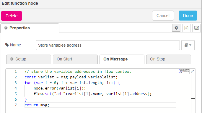

A better option is to use a function node to store all the variables addresses :
At init, the inject node send a msg to myVariables nodes and then myVariables will send the list of variables. The "function" node receive the list and creates the addresses references in the flow context
 The code in the function node is  :
// store the variable addresses in flow context
const varlist = msg.payload.variablelist;
for (var i = 0; i < varlist.length; i++) {
    node.error(varlist[i]);
    flow.set("ad_"+varlist[i].name, varlist[i].address);
return msg;
 It is a loop on all the variables in the varList, and it stores the information : add prefix "ad_" to the variable name and store the address.
With this functions, all variables have thair addresses stored in the flow context.
If symbol file is changed, you just have to refresh the list in "myVariables" node.
