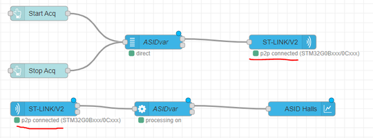

I am new to the STM32CubeMonitor and use it for the first time for acquiring data from a STM32G0B1RETx MCU without using the IDE's Debug mode. The 'probe' is a ST-LINK/V2, connected to pins PA13 (SYS_SWDIO) and PA14 (SYS_SWCLK). The CubeMonitor reports 'p2p connected', see the MON screenshot below. However, the log file (STM32CubeMonitor.log) has many entries stating that an 'Error on connect' occurred. See the the log lines below the screenshot. The result is no data are acquired and no log file was generated.

stephane.legargeant
Hello
Connection error :
The error you are seeing may be linked to connection issues or conflicts with another application :
  • Connection issue : using long wires or having a "noisy" environment may generate communication issue. It is good to try a lower probe speed to see if connection is improved.  For very noisy environment, Isolated ST-Link will provide stronger protection. (B-STLINK-ISOL)
  • Application conflict : If another tool ( IDE, STM32CubeProgrammer) is using the probe when CubeMonitor is starting, CubeMonitor may detect that probe is busy and log a connection error. It is a temporary error. The solution in this case is to use share mode. STM32CubeMonitor:How to configure shared mode - stm32mcu
How to log data in text :
There is a dashboard node to display text : the "text" node.  You must format the value sent to the widget. There is a special subflow for this : "Single Value". So you need to connect the ouptput of "processing" to "single value" and then connect to "text". the same process is used for gauge and is described here : STM32CubeMonitor:How to send data to a gauge - stm32mcu
Have a nice monitoring and let us know if it is working.
