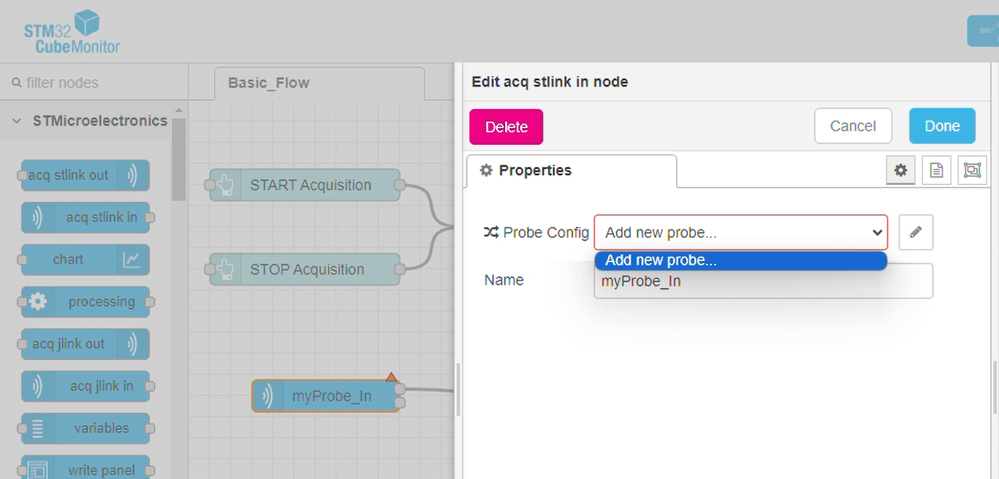

I launch STM32CubeMonitor and it opens the Basic Flow for a simple acquisition. I try to configure the nodes myProbe_Out and myProbe_In as explained in STM32CubeMonitor:How to select the target article, but no probe are listed in the acq stlink in/out node properties:

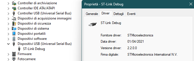

My NUCLEO-G071RB board is connected and its embedded ST-LINK/V2-1 is properly enumerated as ST-Link Debug with the last driver:

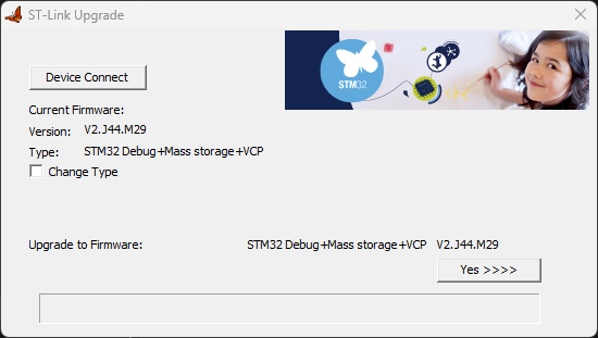

The ST-LINK/V2-1 is updated with the last firmware version:

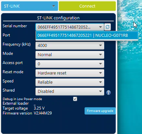

And the ST-LINK/V2-1 is properly detected by STM32CubeIDE and STM32CubeProgrammer:

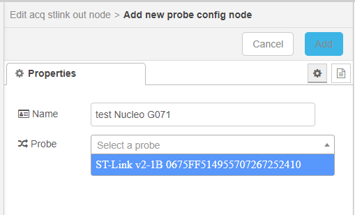

In the screen showing "Add new probe...", have you clicked on the pencil icon ? It should open, a new box where you can select your probe like this :
This windows will crate a "probe config" which is linked to your device and can be used as probe for the Stlink-out and stlink-in node.

Thank you very much, Stephane.
I missed that "trick".
